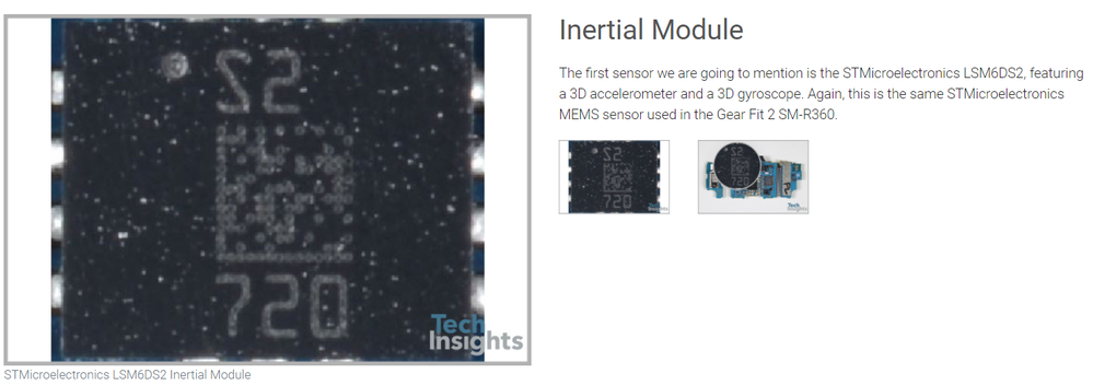

What is the difference between the LSM6DS3 with marking of SH and LSM6DS3 with marking of S2?

Hi @BRani.1​ ,
sorry for the very delay in our answer, but we missed this Q&A.
The "SH" marking is the Mass market code for the LSM6DS3, and, in your case, it is the correct denomination.
The "S2" refers to the same product, but it has been named LSM6DS2 for a specific customer, as you can see from this reference:
0693W00000FCBqvQAH.pngSo no differences from the application side, but the "S2" marking should not be there...
If my reply answered your question, please click on Select as Best at the bottom of this post. This will help other users with the same issue to find the answer faster.
-Eleon
