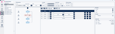

FSM1:
FSM1 is responsible for incrementing long counter everytime the GNTH1 is reached.
FSM2:

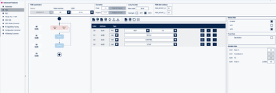

FSM2 is responsible for resetting long counter. I don't really understand why the MEMS Studio forces me to put STOP command at the end of the FSM2. Will it halt the FSM2 and could that cause any issues? I have tried to remove this command and click "Write FSM configuration to sensor"  but then the STOP command automatically appears again at the end...

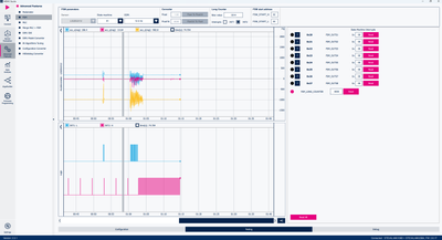

The results are below:
For some reason, the INT2 latches and does not reset. I cannot wrap my head around why it does not reset even though my FSM2 has RSTLC.

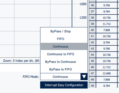

If any of the programs makes use of the long counter through the commands described above, the FIFO must be
enabled in continuous mode. Refer to AN5909 for more details on the FIFO buffer
Does that mean I need to use FIFO?

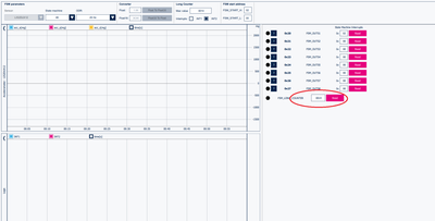

I have tried to enable and select Continuous mode. When I go to FSM Testing tab and move the device and Read the FSM_LONG_COUNTER register value, I see its stuck at 0014 and its not being reset back to 0 after period so it seems that its also not working

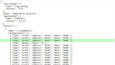

  • As you stated if any programs makes use of the long counter the FIFO must be enabled in continuous mode, this should be done inside your configuration adding 15h register write request with value 0x06 before writing FSMs configuration (see image attached and I will send you the updated configuration file in private message)
  • Once FIFO is enabled you will no more see INT2 signal latched, instead once max long counter value is reached, INT2 will go high, on every INT status data read it will go down and again up until RSTLC command is executed.
