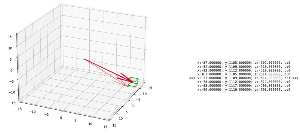

Below is an image of the visualized output data with the sensor being in a stable environment, where the one reading above the pulsed has the byte-flip recorded on the X-axis.
Here we can see that the previous normal value in hex would be 0xFFAE and then the impacted reading is with a value of 0x00A7 (AE and A7 are within error), so a complete byte flip has happened, and not even "zeros to ones", but "ones to zeros". Note that there have been plenty other situations as previously described where 00->FF, this is an example of the opposite effect, since the record state was with a negative vector value, but with a positive vector value the bit/byte flip would make zeros to ones.

So the pin configuration is per datasheet spec with supply voltages voltages 1v8 for 4 sensors and 2v2 for another 2, but all tested sensors experienced the bit/byte flips. Below is a screenshot from the vector outputs in their value form:
The vector values are displayed in deciGauss; normal value ~-5.65

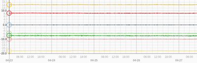

It has come to my attention that the hard-iron offset may be causing these bit/byte flips.
I ran a test where I left two pairs of sensors running for 5 days (~120h), where one pair has the HIO turned off and two have it turned on, but the offset is written only once during startup. And the results were interesting.
The pair with HIO turned on and the offset values having written only once during boot:
(the pink axis has a spike at ~6am on the 24th; the red axis has a spike at ~6am on the 27th)
The pair with the HIO turned off:
(no spikes on the axis)
There are two visible spikes in the HIO-on pair, where the calculated values were in fact a byte flip. Note that I am reading the vector values only every minute, so there could be a lot more of these glitches happening.
If this phenomena can be explained, I would love to hear it, otherwise, I shall be switching the sensor for another that is more stable.
