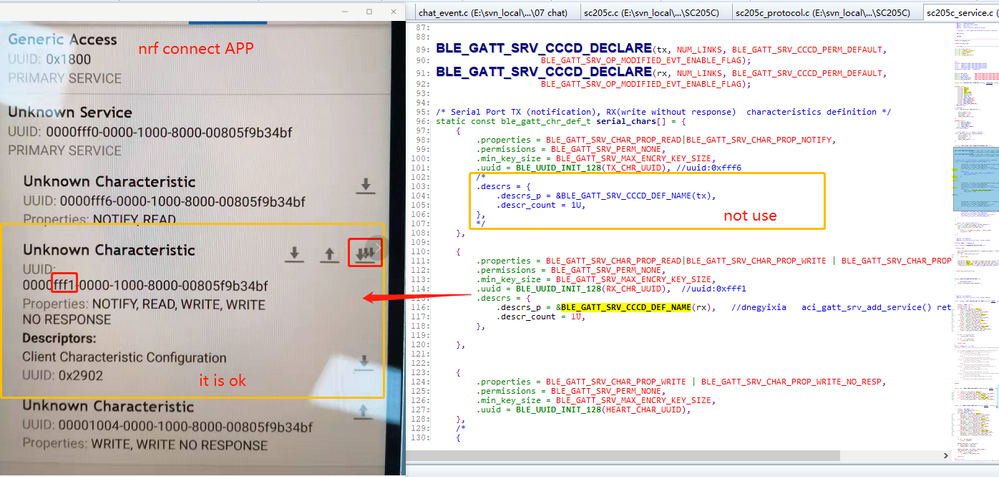

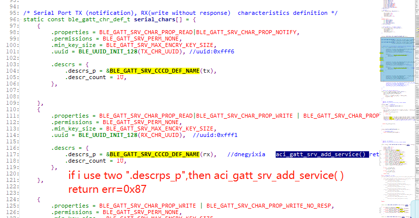

who can help me , i use BLUEBRG-LP 345 mcu,i want let two characteristic show "descriptors" ,and show"↓↓↓" button,in nrf connect APP. but i have error . my english is not good,can see fllow pictures
Fx.1

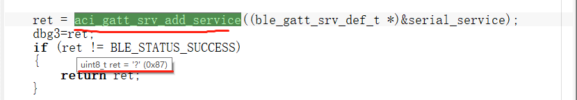

if i use two ,aci_gatt_srv_add_service() will return 0x87 error0693W00000FAVCrQAP.png0693W00000FAVGPQA5.pngbut use only one,it is ok

Not sure to get 100% of your request. Anyway, 0x87 issue might indicates out of memory error :
#define BLE_STATUS_OUT_OF_MEMORY      ((tBleStatus)(0x87))
To avoid this, please check your code_example_config.h
Code examples from BlueNRg-LP SDK are optimized in terms of memory consumption according to number of link, services, characteristics,... used by this example.
If you add service or char to an existing code example, you may need to change config accordingly.
As an example, you may increase :
  • NUM_APP_GATT_SERVICES_CONF
  • NUM_APP_GATT_CHAR_ATTRIBUTES_CONF
To help you in this configuration, a "BlueNRG-LP radio init wizard" is available together with DK (available from Windows menu as per SDK)

hi,Sebastien DENOUAL (ST Employee)
thank you very much,
i set change
#define NUM_APP_GATT_ATTRIBUTES_CONF
from 6 to 16,
now it is ok.
you are very powerful ,thank yuo.
