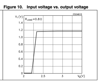

The ST1S06xx datasheet (https://www.st.com/resource/en/datasheet/st1s06.pdf) contains an error: Figure 10 "Input voltave vs output voltage" has the axes labels swapped:

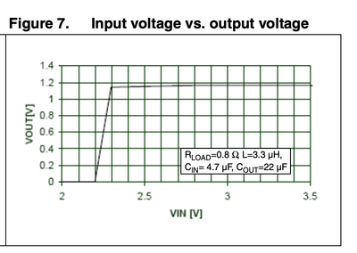

A correct version of the Input voltage vs output voltage characteristic can be found in figure 7 of Application Note 2371 https://www.st.com/resource/en/application_note/an2371-st1s06-high-frequency-synchronous-buck-converter-stmicroelectronics.pdf :

Thank you very much for the careful observation regarding the diagram fig 10: the labels Vi and Vo were indeed swapped. I will gladly report this further, but I am unsure whether it will be corrected anytime soon given the age of the device (it was released in 2006).
