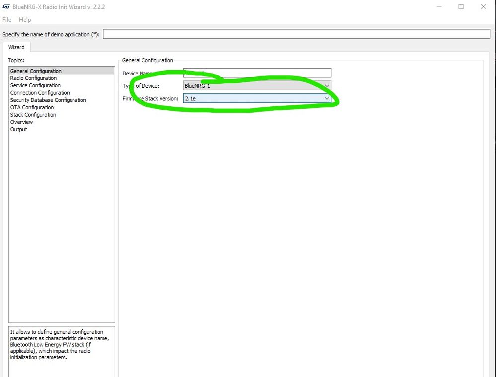

I am trying to build my Bluetooth application by configuring the services and characteristics I need. I saw ST recommends using BlueNRG-X Radio Initialization Parameters Wizard.
I am using BlueNRG-M0 (X-Nucleo-IDB05A2) and I read the FW version and HW version from the board.
HW Version - 49(dec)
FW Version - 1840(dec), 0x730 (FW 7.30)
I want to know what FW stack version do I use in the Radio Init Wizard program (see attached picture). I assume the BlueNRG-M0 is a BlueNRG-1 device. Is that correct?

    Hi @MD'Si.1​ ,
    BlueNRG-X Radio Init Wizard intend to be used with BluuNRG-x SoC ONLY.
    BlueNRG-M0 module is based on BleuNRG-MS which is a BLE network processor.
    With BlueNRg-M0, you need HOST microcontroller (typically STM32) to run your BLE application.
    About SW, I recommend to use "X-CUBE-BLE1" SW package available on st.com (this package is compatible with CubeMx).

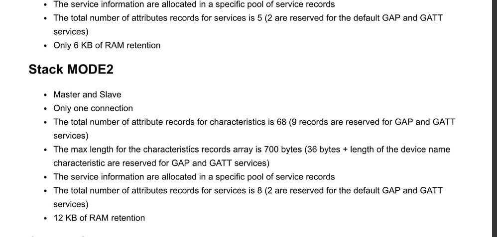

    I have one question on the limitations of the different stack modes when reading the documentation.
    What is the limiting factor when creating services or characteristics? e.g. the stack supports 700bytes - (36) - (device name length) for characteristic records. Does that mean that the length of all my characteristics needs to be ~660 bytes?
