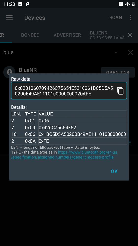

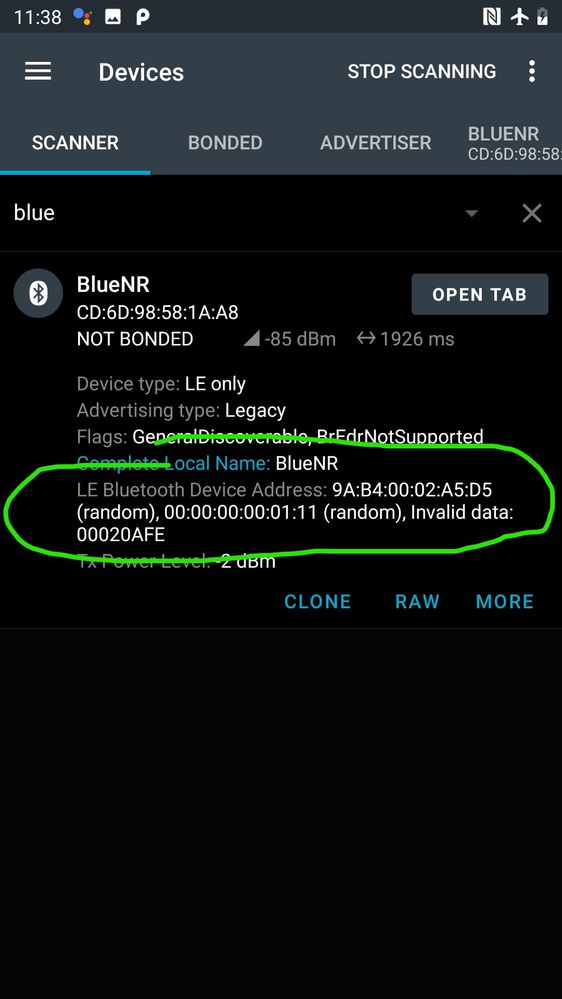

@Sebastien DENOUAL​  ​Thanks for the suggestion. I am using the example you suggested and I still see incorrect behavior. The uuid I am trying to add to the advertising packet is 000000000001-11e1-9ab4-0002a5d5c51b which is the one used in the BLE Sensor APP example code (HW service)
I don't think the aci_gap_set_discoverable() has been verified with a uuid 128 list. The function or some underlying call does not account for the AD Type to be inserted just like the local_name variable. I tried 3 things below and each time the advertising packed was either nor formed or formed incorrectly.
  1. If I add my uuid without an identifier of AD_TYPE_128_BIT_SERV_UUID (0x06) the functional call is successful but the advertising data is not correctly formed. The AD type byte is missing so the packet is identified with type 0x00 (It should be 0x06 which is Incomplete 128bit UUID service list).
  2. If I add the AD_TYPE_128_BIT_SERV_UUID to the uuid array and declare a length of 17 the function call fails.

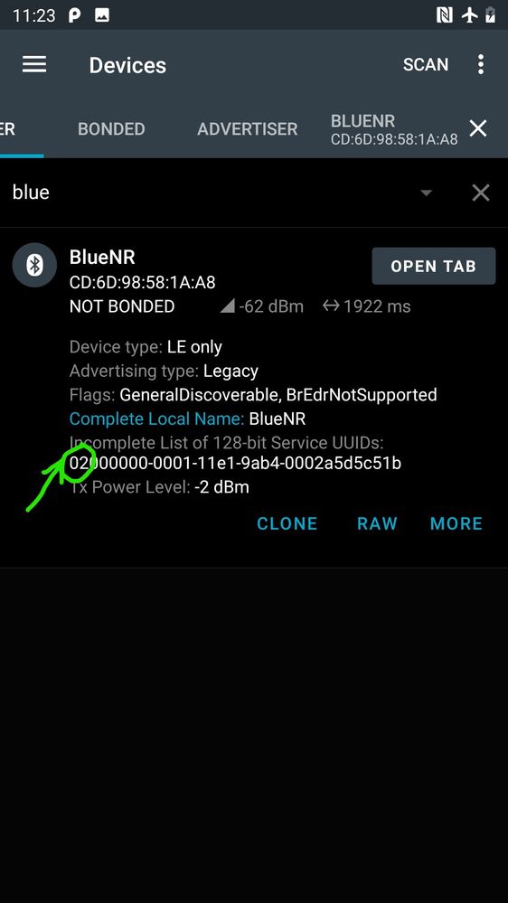

  3. If I add the AD_TYPE_128_BIT_SERV_UUID to the uuid array and declare a length of 16 the call is successful but the first byte of the uuid is 0x02 which must come from the Tx Power info that is appended to the Advertising packet.

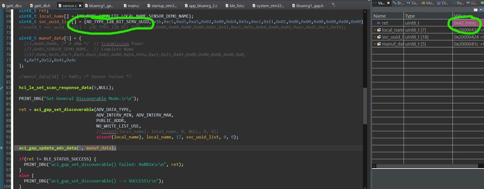

@Sebastien DENOUAL​ I was able to get the service list to work with a 128 bit uuid and I did have to declare 17 octets for the function to work. To make it work I had to reduce the size of the local advertised name by about half.
Is there a way to increase the size so I can have a longer name and a 128 bit UUID. I have seen other bluetooth 4 chipsets support this feature so is it a configuration issue?
