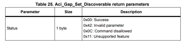

Pgonz.1
Hi, I also have the same problem, did you solve it?
I tried to debug and the value of ret here "ret != BLE_STATUS_SUCCESS" is 0x46 for me.
I have no idea why, it should be one of this values: 0693W00000FDJ5fQAH.png
