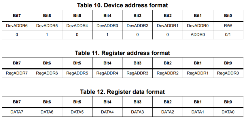

STUSB1700 What is Function of ADDR0 pin ? Is it for Read/Write operation or just write. It needs external pullup? What should be connected to enable this. Thanks

As the datasheet says: with the pin ADDR0 you define bit1 of the address under which you can address up to two STUSB1700 devices via the same I2C bus.
With pin ADDR0 on low you can reach the STUSB at address 0x28, with ADDR0 = high under 0x29. You can achieve it with a pull resistor, with a direct connection to GND or VDD or with an MCU GPIO.
bit7 bit6 bit5 bit4 bit3 bit2 bit1   bit0
 A6   A5   A4   A3   A2   A1    A0     R/W
 0   1   0   1   0   0   ADDR0   0/1
Good luck!
