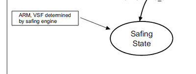

Our use case does not include external sensors (i.e., no sensor data read in Safing State), and we are not using the Remote Sensor Interface  and  ISO9141 features.

FENH
External arming enable for high-side drivers (active high) – used when there is no use sensors, and safing State ARM and VSF won’t be valid   as seen in figure. 9)
FENLExternal arming enable for low-side drivers (active low) – also used when no sensor input is available, for the same reason as above
ACLAdditional Communication Line – required to enter Arming State, as per ACLGOOD = 3 condition in Figure 9

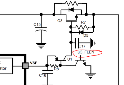

uC_FLEN
In the reference schematic, uC_FLEN appears to be used as a GPIO from the MCU to control a FET in the VSF-powered safing path — is this correct? Could this function alternatively be driven by one of the L9678P’s GPO drivers to reduce MCU pin usage? (typically near U1 as shown in Figure 58)

  • uC_FLEN:In the reference application diagram, I noticed that the uC_FLEN signal from the MCU appears to drive the gate of an N-channel FET in the safing path (related to the VSF-regulated supply). I would like to confirm:
    Is my understanding correct that uC_FLEN is a control signal from the MCU used to enable or disable the safing FET path (typically by pulling the gate low)?
    What is the recommended driving strategy from the MCU for this pin?
