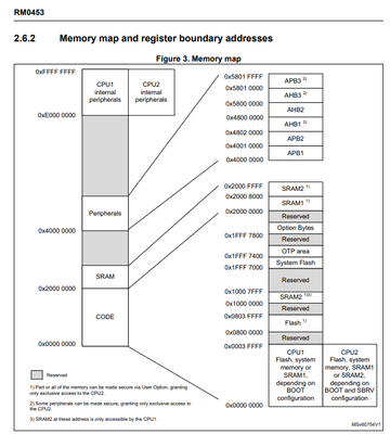

I am looking for a memory map for the stm32wl5moc.  I thought I found one before but cannot find it again.  It is not in the datasheet.  Any suggestions?  Thank you.

From RM0453:

Thanks; a coworker pointed me to that reference manual, versus the programmer's manual or datasheet.
