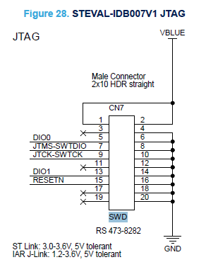

Second thing is, how to flash bin file in BlueNRG-1 (
https://www.google.com/url?sa=t&rct=j&q=&esrc=s&source=web&cd=3&cad=rja&uact=8&ved=0ahUKEwjDpY2FnsPaAhVLr48KHfe1B2AQFghKMAI&url=http%3A%2F%2Fwww.st.com%2Fen%2Fevaluation-tools%2Fsteval-idb007v1.html&usg=AOvVaw3i6izof7evi3qO3d1IfkTm
) using Ubuntu ?
(I have segger J-link with installed driver on it)

Dear Vikrant More,
for the time being, this specific software package does not support Linux, yet.
If you want to flash your .bin files using Linux, you can use the JTAG connector of your STEVAL-IDB007V1 board in SWD mode.
Since you already have J-link, you can use it for this purpose.
As an alternative, if you have an STM32 Nucleo board, you could use its ST-LINK/V2-1 to program and debug the board. In this case, after you connect the SWD pins of your STM32 Nucleo board to the corresponding ones of
your STEVAL-IDB007V1, you may simply copy the .bin file to the virtual mass storage drive created by the STM32 Nucleo board in order to flash your file.
