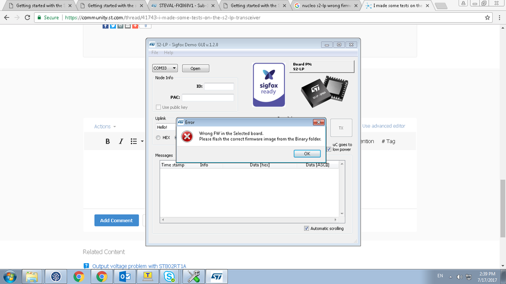

I bought the
STEVAL-FKI868V1
development kit and when I try to open the COM port on the GUI, I get the following error message:
''Wrong FW in the Selected Board''. I go to the Binary folder in the application program files and I drag and drop the SIGFOX_CLI_DEMO_NUCLEO_L1_ETSI.bin file to the mbed drive and press the reset button. I try to open the COM port again in the GUI, and the same error message appears. There's nothing on the serial port as well on my terminal when I reset the board. Are there any extra steps which need to be taken before trying to open the port?
Any assistance would be appreciated.

Firmware is stored in 'C:\Program Files (x86)\STMicroelectronics\S2-LP_SigFox_DK_1.3.0\Binary' or similar folder, depending on the software version. It seems they are the same for FCC and ETSI now.
Posted on May 10, 2018 at 04:24
Yes. In the latest DK, it supports different zones with the same library.
Please choose MCU accordingly. Currently F0, F4, L0, L1 are available.
