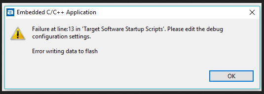

Anyhow, using Atollic 8.1 with blueNRG1 and ST Link debugger  - just fail to program the chip, resulting with this error:
Atollic support team are familiar with this issue (using blueNRG1 and ST Link), and here is their response:
we've had previous customers using BlueNRG-1 and 2 who are experiencing this issue.
It seems to be because those projects does not fill all sections to be aligned by 4.''
(Atollic support team are really worth compliments for their proficiency and quick responses).
ST team, Gerado, please advice what is your solution, again, you have published that bluNRG1 is supported by Atollic so please address this issue and fully advice how.
Posted on May 09, 2018 at 16:26
A fix is needed into linker file (and this fix will be available into next SDK release).
This line:
*(i.*) /* i.* sections (code) */
needs to be added into linker file.
I have the one for BlueNRG-2 (in attach). Line #
You can diff with the default one, and modify your linker file for BlueNRG-1.
Letus know if it works also by your side.
