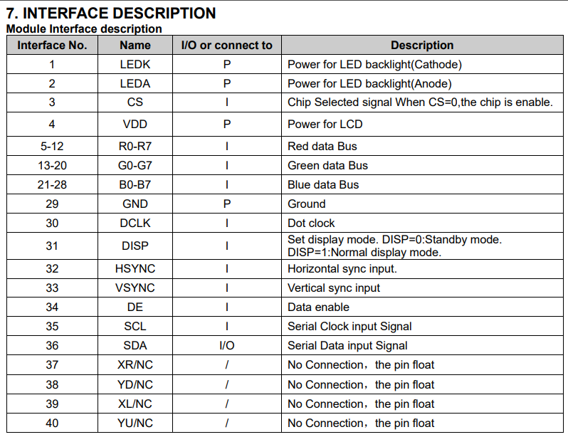

Hello, I'm very new to STM32 and LCD RGB. Currently, I bought the LCD TFT AFY480272A0-4.3INTH. It says that the interface uses a 24-bit parallel RGB. Can I drive it using the NUCLEO-F767ZI? And, how do I connect the flexible cable to the Nucleo pin?

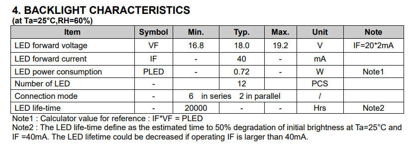

Thanks, I'll order it soon. But I'm still confused about how to set the brightness on the Nucleo. The backlight has two pins, an anode and a cathode. The forward voltage of the backlight is 18V.0693W00000Y81KnQAJ.png0693W00000Y81MAQAZ.png
