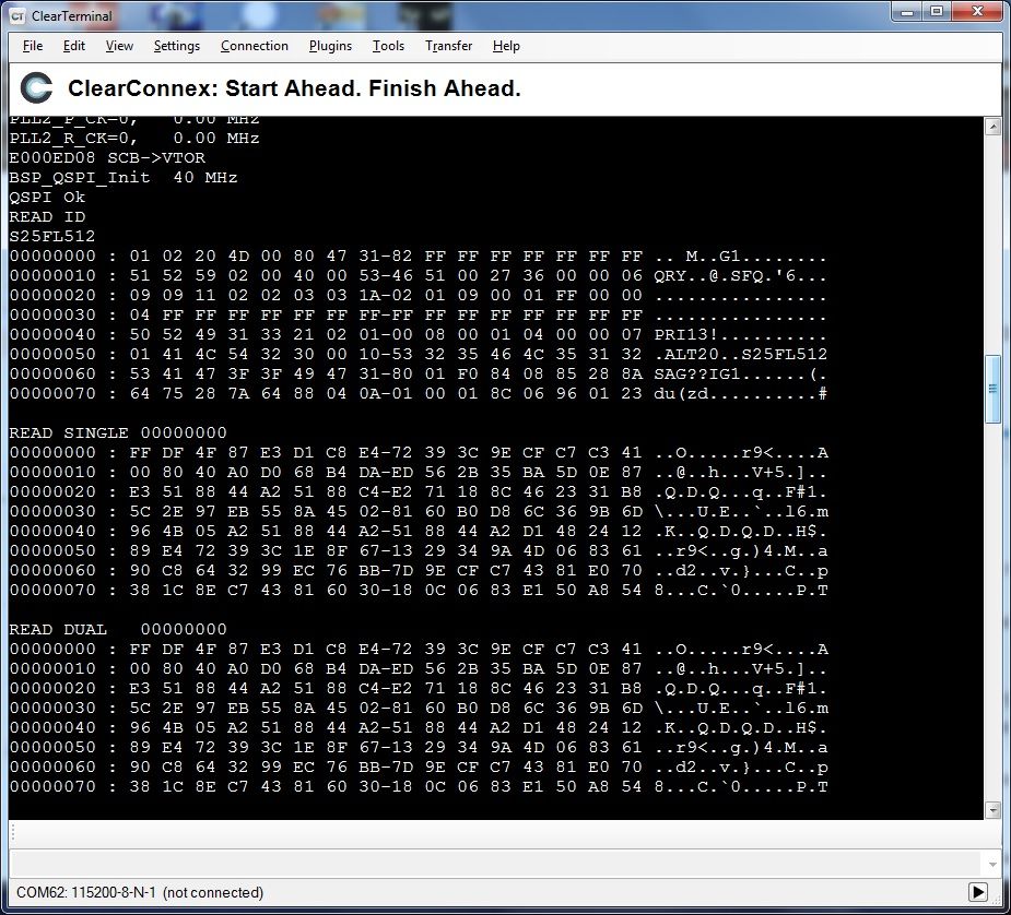

Hi Clive,
I'm looking for a driver similar to this but for S25FL512S
Don't laugh - this is my first project with a QSPI flash.​ STM32H753XIH6 custom board.
I took the BSP example from STM32H743-EVAL2 for the QSPI itself. Initialization of the QSPI seems successful but then I cannot even read the flash ID or status reg without errors in simple 1-line mode.
The flash is connected with all 4 data pins, on bank1. Bank 2 has a QSPI SDRAM (not enabled yet)

For those who may find this thread in future - ST support answered that the driver for S25FL512S is in the board BSP examples for QSPI - here is one for STM32469I_EVAL:
https://github.com/STMicroelectronics/STM32CubeF4/blob/master/Drivers/BSP/STM32469I_EVAL/stm32469i_eval_qspi.c
This code works with S25FL512S and N25Q512, in fact the commands are defined in the n25q512.h though many register bits differ.
This driver supports only common basic operation of the flash, no specific features of S25FL512S or N25Q512.
 To summarize - take the above ...eval_qspi.c file + one or both .h files for S25FL512S and N25Q512 (and as I wrote this should work also with S25FL256S). Then add advanced i/o modes and specific features such as DDR, protections, ECC...
