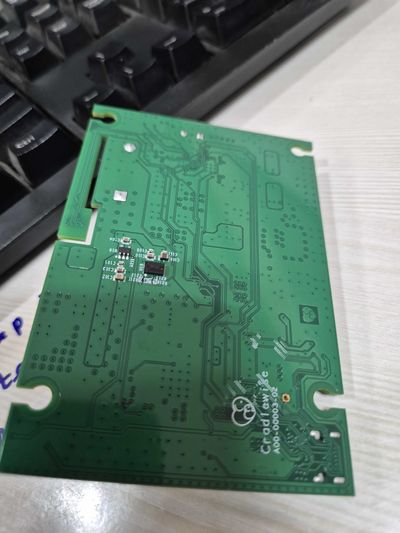

BTW, the PCB goes through a reflow cycle and a wave soldering cycle. The sensor is protected using special wave soldering PCB fixtures. Do you see this as a concern ?

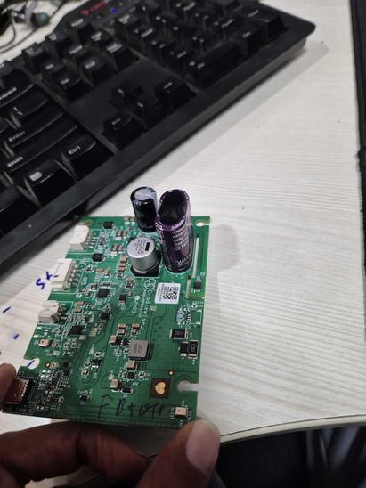

BTW, attached are the images of the PCB with VL6180
