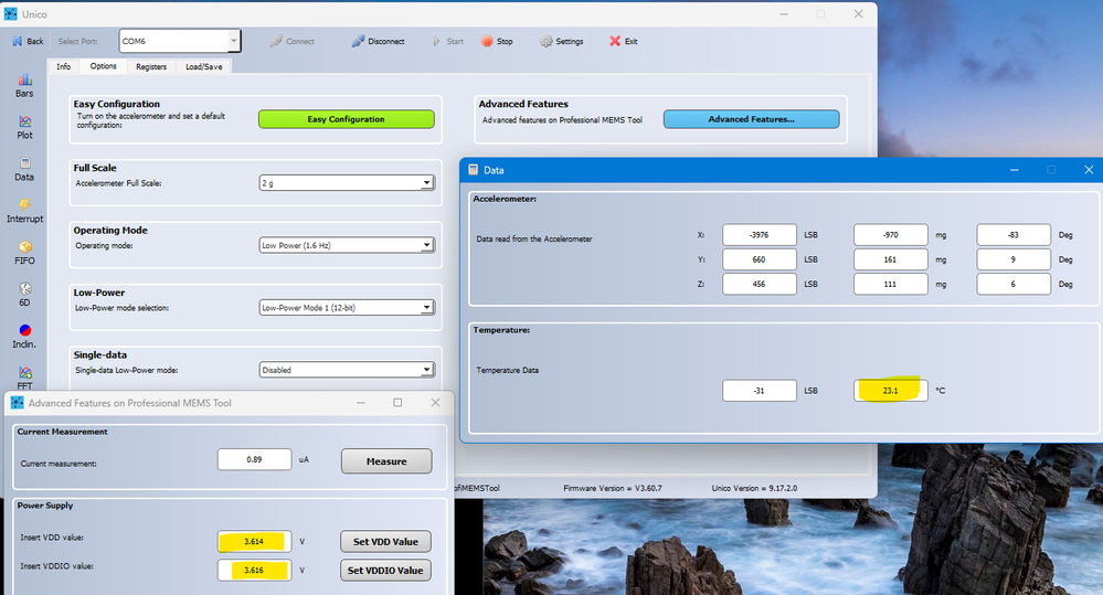

Hello everyone,
We manufactured about 100 boards for a pre-production run using the LIS2DTW12, and at room temperature, the boards are all over the map with +/-3°C accuracy, nowhere near the "typical" +/-0.8°C as stated in the datasheet.
I've already seen the other post regarding temperature accuracy issues for the LIS2DTW12, but I did not see a resolution or an accepted solution in that post, so to me at least the problem was not solved.
Our production volume is 10k+ a year, and we've selected this part because of the temperature accuracy features. I know the data sheet does not show min/max for temperature accuracy, but on a sample of 100 boards, the sensor is nowhere near the "typical" values.
Also, I noticed a large temperature variation with the supply voltage: on the EV board, if you change the VDD from 1.8V to 3.6V (using the Advanced Features) the temperature readings (in Data panel) are jumping up by 2°C!
There is nowhere in the data sheet any information regarding the temperature dependency with supply voltage (a graph or a note stating the VDD at which the +/0.8°C typical values were measured would have been very helpful).
Could anyone shed some light on how we can get close to the "typical" +/- 0.8°C? We can't afford calibrating every single board in production.
If there is such a graph for temperature vs VDD, can anyone provide it? To me at least, it looks like the 0.8°C was measured at 1.8V, but our boards are working at 3V and at 3.6V, so if we need to add an offset, I would like to know the temperature measurement change with VDD.
Thank you!

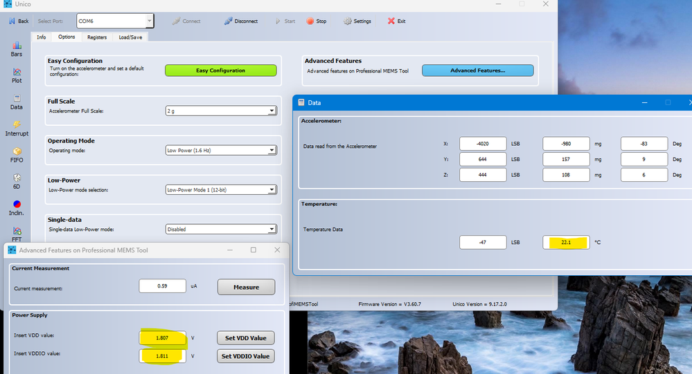

I see the temperature difference in the range of 19°C to 23°C.
On the boards we already built, some boards will only go up by 2.2°C higher than expected, and some boards will go all the way up to 4.9°C higher than expected.
I know the datasheet specified that the +/-0.8°C was measured at VDC =1.8V, but my supply voltage is 3.3V. There are no heat sources on our boards, and the temperature measurements are done at 1.6Hz/12 bits, once every 30 seconds. The microcontroller is in sleep mode, and the power consumption of the board (LIS2DTW12, microcontroller and peripherals) is 0.9uA in sleep mode. The measurement takes a few ms and the current is as high as 75uA, every 30 seconds. That's not enough to heat the board and impact the measurements.
I used both low power 1.6Hz with 12bit and high performance 800Hz with 14bits, but other then the refresh rate and the LSB, there's no significant change in temperature measurements.
However, changing the VDD and sometimes the VDDIO as well from say 1.6V to 3.6V on the EV board with an MKI190V1 adapter on it will show changes in temperature measurements by as much as 3.5°C, always going higher with VDD. That's why I'm thinking there must be a correlation between VDD and the temperature value, and if that is true, a graph or a formula available, that would help a lot.
Also, one more thing: when testing temperature on the EV board, the longer I run the test, the bigger the error. It looks like there is a self-heating effect as well, so I ran the tests at low power 1.6Hz and 12 bits.
I also extended the MKI190V1 adapter with extra sockets. I used a set of intermediary pins to move the adapter away from the EV board, just in case the EV board is generating any heat.
Here are some tests done with the EV boards.
Please note that my ambient temperature is 19.0°C, and I have no other heat sources or fans around the EV board.
At VDD = 1.8V
At VDD = 3.6V
The tests done on the 100 boards we already built are in line with the measurements you see from the EV board: always a few degrees higher than the actual temperature.
Thank you for all the help!
Vlad
