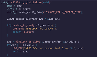

The vl53l8cx_is_alive() function is called right at the beginning of main, but we have tried to add a delay before calling to give the system time to get fully powered up without effect.

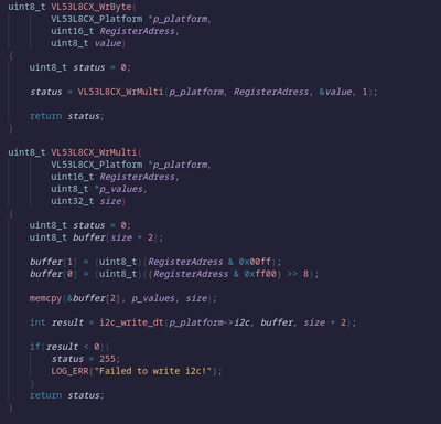

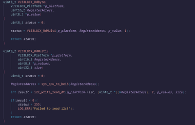

As we are using ZephyrRTOS and the NRF9151 I've had to implement the platform layer functions for i2c myself. I've used the VL53L1x driver that was already present in the ZephyrRTOS repository as the reference for this.

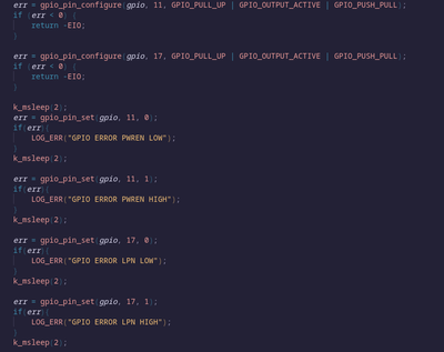

Additionally, we have purchased a x-Nucleo-53L8A1 development board to use with our NRF9151DK development board. When using this setup we are manually setting the lpn and power-enable pins high before calling the is_alive function. We have tried various gpio_configure flags without success.

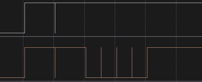

However, when using this setup we are experiencing strange behaviour on the i2c line. The clock line is permanently pulled high and the NRF9151DK doesnt seem to be able to sent the clock signal.
The first spike going down on the clock line(white) and data line (orange) is the power enable pin being pulled low and then high again after a few milliseconds. The data line is then pulled low and as there is no clock signal it stays low until the 500ms timeout is reached, which are the spikes you see on the data line, 4 messages timing out after 500ms.

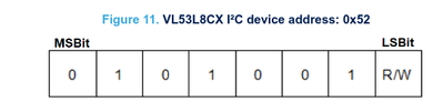

Hi Andrew,
The datasheet says it uses 8 bit addressing, but it looks like that just means 7-bit address left justified with a r/w bit on the LSB. Which unless I'm mistaken is the default behaviour of i2c in Zephyr and most i2c.

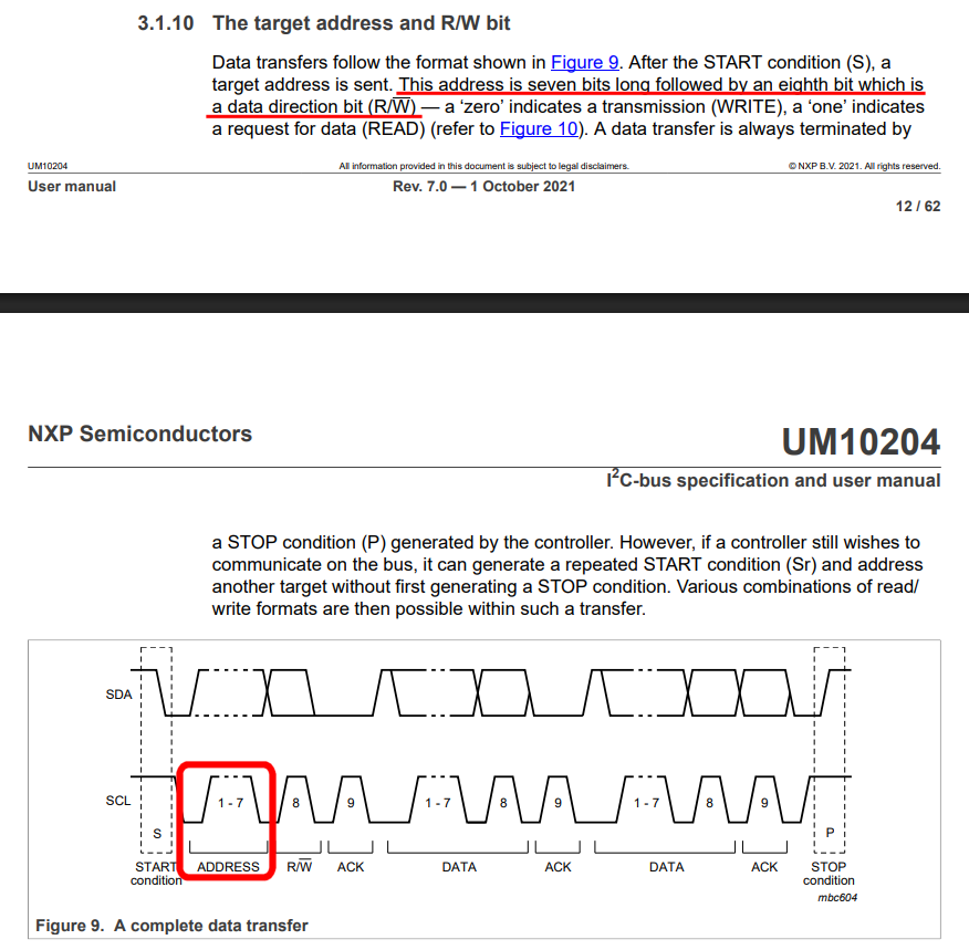

That's just plain wrong. I2C addresses are, by definition, 7 bits; the R/W bit is in addition to the Address:
https://www.nxp.com/docs/en/user-guide/UM10204.pdf#page=12
Unfortunately, this is an extremely widespread mis-description and source of endless confusion:
https://www.avrfreaks.net/s/topic/a5C3l000000UXMPEA4/t142031?comment=P-1150738
The other question is how the Zephyr software driver expects the address to be presented.
Software authors & documentation are also notoriously bad here.
#I2CAddress
i am aware, thats why i added "but it looks like that just means 7-bit address left justified with a r/w bit on the LSB." and the image showing that exact thing you also describe.

@RobinSuneti wrote:
Looking over the datasheet for the vl53l8cx it says the lidar should be 0x52 and 0x29 is not listed as an alternative address.
They are the same thing, shifted:
0x52 =    0 1 0 1 0 0 1 0
0x29 = 0 0 1 0 1 0 0 1

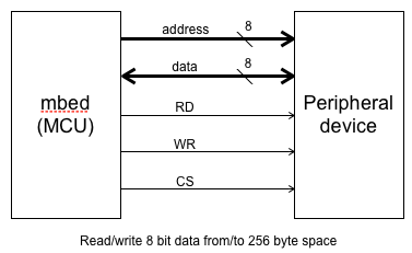

It's like a traditional parallel bus with a direction line (or lines) separate from the address lines; eg,
https://os.mbed.com/users/nxp_ip/notebook/parallel-bus-access/
