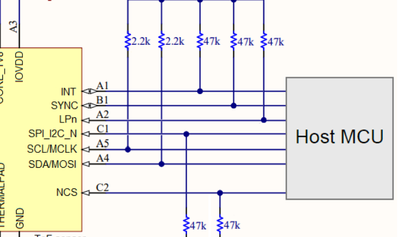

Thanks for your response. But the VL53L8CX sensor doesn't have a sync IN pin; there are GPIO1 and GPIO2 pins. Thus, instead of the SYNC pin, I made GPIO 1 an input. Then I tried to debug the sensor for external triggering in autonomous mode, but it didn't work.

See page 15 for your external sync question. The SYNC pin is GPIO2 (B1) and you need to use a 47K pullup resister to IOVDD.  Set your trigger pin on your controller to LOW (pulling B1 to GND) until you are ready to trigger. The trigger will occur on the rising edge > 0.7v when you set the trigger pin HIGH.
" The external synchronization can be enabled or disabled by using the function
vl53l8cx_set_external_sync_pin_enable(). Ranging can be started using the function vl53l8cx_start_ranging().
The sensor waits for the external SYNC signal to trigger the next measurement process. To stop the sensor, the
user must assert a stop condition in the system, and then on the next external SYNC pin assertion, the
vl53l8cx_stop_ranging() function should be executed.

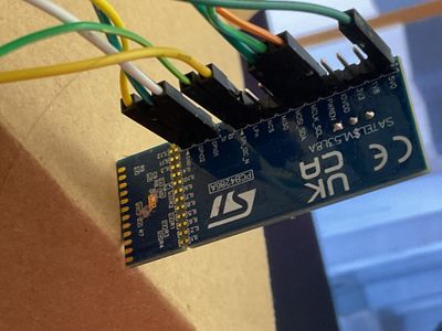

Thanks for your response. I am applying an external trigger using the STM32F401RE microcontroller. It is working, but now I am facing an issue: when I covered the built-in laser and ambient sensor using copper tape and black tape, I got negative values in the room light. Why?
Hi
When you cover the TOF sensor with copper tape and black tape, the light path from emitter to receiver was blocked, the TOF is based on time of photon flight, so the time information was totally wrong if you cut off the light path of emitter and receiver.
BTW, please check the range status at same time, normally if you read out range value is negative, the range status will be 4 instead of 5(valid)
