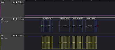

Blue666
As shown in the figure, VL53L4CD_ClearInterrupt was called, but the interrupt pin still is at a low level. I have tried that under normal circumstances, after calling VL53L4CD_ClearInterrupt, the interrupt pin will become high level

Blue666
Could someone help me check if there are any problems with my code?
Is it necessary to add a call of VL53L4CD_ClearInterrupt before the call of VL53L4CD_StopRanging to avoid this problem?
if you don't clear the interrupt before stopping the sensor will consume some power pulling that interrupt line low.
So clear it, then issue the stop, and as discussed, use the latest driver.
if you find you issued the clear and it didn't clear, then you've somehow lost communication.
the I2C is not a very robust bus. and noise can stick it.
Check to see if either the clock or data line is stuck low - that is a common symptom.
if so, stronger pullups might be required along with all the other noise reduction techniques.
- john
