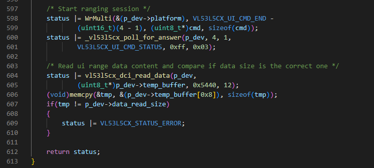

For the last several days I have been battling this API for the VL53L5CX and finally reached the point where the initialisation passes every time. I proceed to set some of the configuration parameters (mostly resetting to the default values suggested in the application note). These functions also return status = 0.
Then I start a ranging session. The problem is that checking the status/error output shows me that the function is failing with a 255 error. Further investigation with a debugger has yielded that the final if() check in the function sets the status too 255. This means that the data_read_size check has failed. see screenshot below for reference.
I should note that, every single function and I2C transaction passes with no error. In other words, status = 0, the whole time, until this if statement. It is the physical value of the variables that does not match. Has anyone else had this error? or can offer some suggestions as to what is happening and how to fix it?

check the value of status prior to the final check. My thought is that they are all failing, but at the last line you set it to 255 masking all the other failures.
I like status += function() better than status |= but there are advantages to both.
print out thd two values that don't match - and should.
There might be an answer there.

I am using a debugger to individually step through each line and monitor the status. it remains zero until it enters the if statement. there it gets set to 255. With the debugger i can see the variables as they get edited. the value of "tmp" is read out as 0 from the temp_buffer its pulled from. Inspecting the I2c communications with a logic analyser also shows that the sensor is sending back "0'.
The question remains, how does every other read/write pass with no errors, and yet this check fails

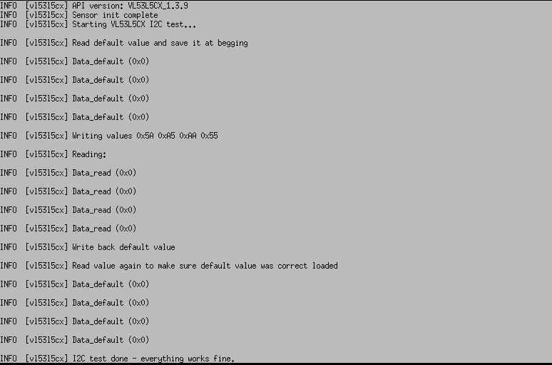

I am having similar issues to the original poster. It seems that I am able to init the vl53l5cx but when I try reading any data (not just ranging), even the resolution, it returns 0 for the data but also returns 0 for status...very confusing.

It appears that when I specifically try to read the data buffer for resolution, the swap buffer has a bunch of zeros. When I compare the tmp with p_dev->data_read_size I always fail this check, again due to swapbuffer only getting 0's from the device.
2024-03-19 09:37 AM
If you are not getting any answers back - everything zero - then I'm going to guess you did not get the processor started.
During the initialization phase you need to download some 80K of data. With the last byte, the ranging engine will start.
Could you have a look at the code in:
Solved: How do I verify I have my I2C configured correctly... - STMicroelectronics Community
And add that to the top of your program.
Hopefully it will verify your I2C interface.
- john
2024-03-19 10:13 AM
Thanks John! So the strange thing is the return status is fine, but there is no data being received.
I am able to pass all the poll for answers at firmware update. Now I did have to chunk out the firmware update into blocks <=1024 bytes, and this may be the issue. I am running on an nxp s32k344:
