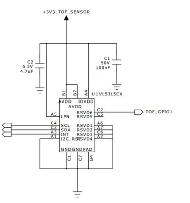

2024-08-29 9:31 AM
you need 'number of valid targets' as well.
To determine a range, the logic is:
If (the number of targets is greater than 0, AND the RangeStatus is 5, 6, 9 or sometimes 12) then use the range for that zone.
But to do this, you do need 'number of valid targets'.
At least I think so. I replied just yesterday to a similar question, but I have not heard back if it solved the issue.
My assumption is that we never checked this case, as we knew it was invalid.
- john

i'm new using VL53L5CX and i would start a simple ranging example.
I have setted VL53L5CX_NB_TARGET_PER_ZONE == 1 and i'm using the the example in the folder.
The init function is ok but i'm unable to start ranging. Below our schematic and my code
