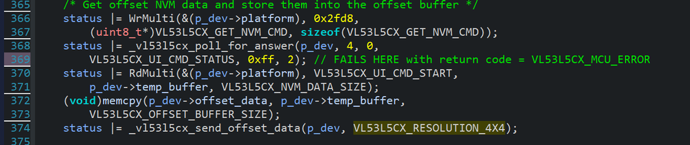

I tried using VL53L5CX with ULD API v1.3.6 with an ESP32-S3. I successfully ported the base C function for I2C, as I can talk with the sensor during the first part of the initialization process.
Unfortunately, when I reach the NVM part, the function _vl53l5cx_poll_for_answer() fails, and I keep getting VL53L5CX_MCU_ERROR as the return value:
I was looking for answers online, especially around ST Community, but I cannot find anything about this specific part of the function failing. As I haven't modified the API itself, I really need some external help to resolve this issue.
Does anyone know how to revolve this ?

I actually found the issue: the WrMulti function was sending adress bytes in the wrong order. It was actually the previous call to WrMulti(&(p_dev->platform), 0x2fd8, (uint8_t*)VL53L5CX_GET_NVM_CMD, sizeof(VL53L5CX_GET_NVM_CMD)); that failed because the 0x2fd8 adress was sent as 0xd82f. My bad, I implemented the function wrongly.
