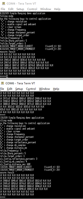

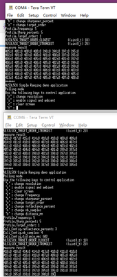

Hi, I have two VL53L5CX and use glass to cover them. We can call them A&B.
To A, I use the VL53L5CX_XTalkCalibration   function after init.
To B, I do nothing.
But result of both are close. Does it mean I can cover the glass without calibration?
