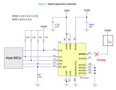

In VL53L5CXV0GC Typical application schematic, The pin RSVD6 must connect a 47 kΩ pullup resistor to IOVDD. If I keep this pin as floating, what will happen? Will power consumption increase? Or is the detection inaccurate?

C2 is a Unused GPIO. It's an output so just pull it up gently and ignore it.
You aren't going to use an significant amount of power.
If you are keeping it floating this could damage the sensor or you could get some false measurements.
