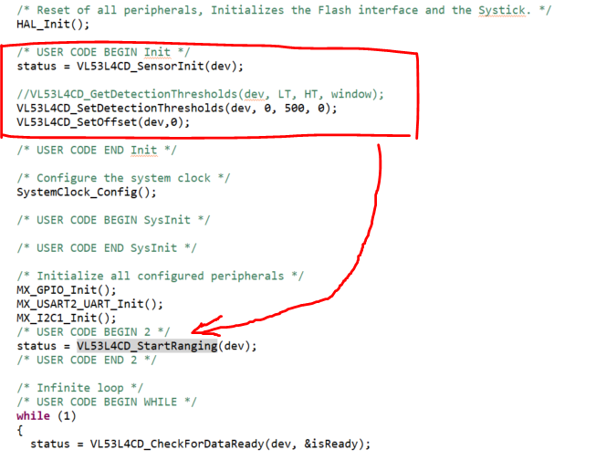

I am testing a VL53L4CD sensor for a measurement application. I am using the example code from the API to test out the sensor and I'm having an issue with the minimum distance of the sensor. It will not report a measurement range less than 70mm and when the target is closer than 70mm it reports range status 3. The API documentation says that range status error 3 means that the distance is below the detection threshold but has no other information about the error. I have tried changing the detection threshold to 0 with the API function (VL53L4CD_SetDetectionThresholds) but it had no effect on this error. I don't see any other information in the API manual that appears relevant, but this API doesn't seem to have as much documentation as the APIs for other sensors (I have used the VL6180X a little bit as well, with no issue). Any help with this is much appreciated.

It's quite strange to see error 3 during test, may I get your L4CD testing code and logs, then I will try to reproduce your issue at my side.

Seems your code sequence is not correct, you need to initialize the L4CD after the platform was initialized.
The example code for VL53L4CD is available on www.st.com

I stumbled across this problem while implementing an integration of the VL53L4CD sensor. I didn't use the library code. After some head scratching I found the problem was not setting all default values for the registers. Many of them are described as "not user-modifiable", but unless you set them to the values from the library the sensor behaves weirdly. In particular, it can't measure anything below 70mm and just gives status 3. Just as you describe.
I think some proper documentation of the registers might help.
