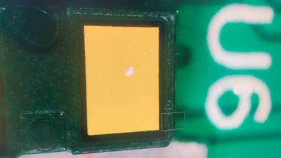

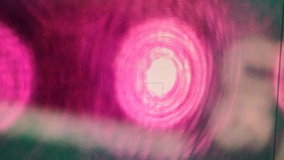

On production units the sensor is protected by glass, with a 3d printed baffle to minimize cross-talk. I've validated that there's no effect from the hardware. The good/bad divide remains the same regardless of whether the glass or baffle is present. I've also validated supply rails are noise free and stable under operation. The "bad" sensors do not look dirty or damaged under the microscope.
I'll be implementing xtalk and offset calibration but I'd like to know if there are any other registers that I should be setting or adjusting? Or could it be that we have a bad batch of VL53L1X  sensors?

Now you have video evidence that you have very little output signal, and that the sensor is actually turned on and operating.
Now you have to figure out why the coverglass of the 'good' sensor is letting the light through and the coverglass of the 'bad' sensor is not.
I have to believe that these cover glasses are not the same.
- john

To demonstrate this I removed the cover glasses and tested again with the microscope.
Bad sensor :
Good Sensor :
There are things that will affect how bright the sensor appears such as angle and ambient light. I've kept those as constant as possible. No matter what way I look at it (literally) the bad sensors have little to no output compared to the good sensors.
So the possibilities are
(a) There are some registers I can adjust to set the laser output.
(b) We have faulty sensors.
(c) Some manufacturing defect (this is unlikely I feel, the boards look perfect and we use a very well regarded PCBA supplier).
John E KVAM
OK, you've convinced me.  Now you have to deal it whomever you bought them from to work out some sort RMA procedure. If they are broken, then ST will want to have a good look at them. Unfortunately, I have no idea how one does that. I've never gone through the process. But the process starts with your distributor.
