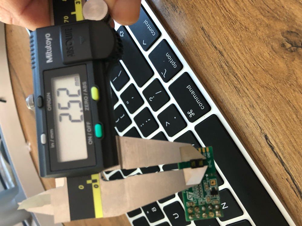

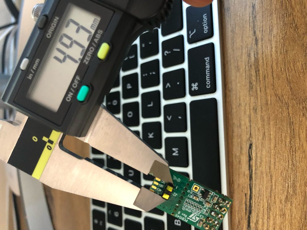

The board PCB1540 is generally identical for both of them, but you can use e.g. the dimensions of the sensors as a distinguishing feature:
  • 53L0-SATEL-I1 (VL53L0CX): 4.4mm x 2.4mm x 1.00mm
  • VL53L1-SATEL (VL53L1CB): 4.9mm x 2.5mm x 1.56mm
The satellite boards should also contain exactly the same chip as the motherboard. To check this, you only need to start the VL53L0X GUI after you have connected the satellites to the main board. The GUI should recognise the sensors.

FBass.1
Hi Peter -
Thank you for the tip on the physical size difference. I will pull out my callipers and put them to the test :) I am not using them with ST controllers so starting up the GUI is not possible unfortunately, unless there is a class or function I can run within the application code to get the info needed.
Alternatively I can of course just buy the VL53L1-SATEL board, then I know for sure :D
Many thanks, will let you know how it goes.
Regards, Friedl.
Hi Peter -
Referring to the images below, it is safe to assume I have the VL53L1_SATEL boards. The bad news is that it has to be my application code then 
Would have preferred to deal with a hardware error to be honest, haha.
Thanks again for your help.
Regards, Friedl.
