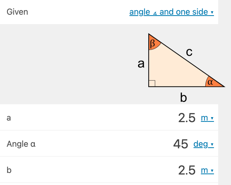

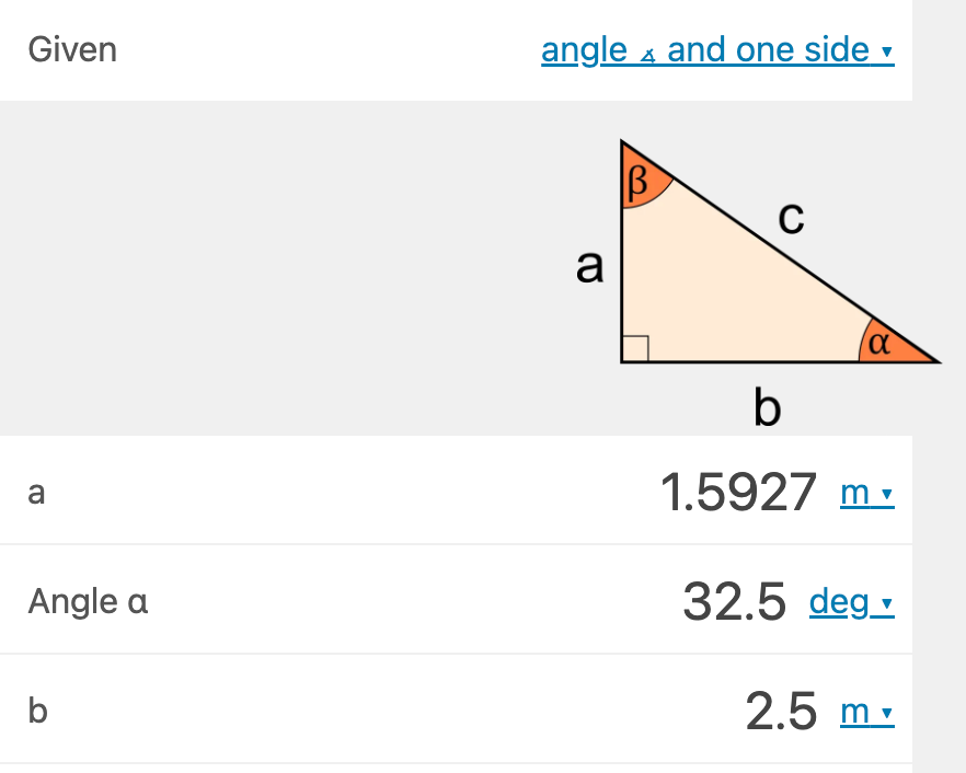

One thing I'm struggling with is understanding what is the effective projected FoV.
I've placed the sensor in my ceiling, which is 2.5m tall, looking down. Since this sensor has a diagonal FoV of 65 degrees, I'm I right in assuming that the projected FoV on the floor is ~1.6m (2.5m is the height of my ceiling and 32.5 is half of the diagonal FoV)? And if so, would each zone in the 8x8 grid actually correspond to ~20cm2?
This is more or less in agreement with what I've seen empirically (~1.65m2), but for my use case I would like the sensor to capture an area on the floor of about 2.5m2.
So my two questions are:
- Are my calculations correct? I'm a bit confused with what diagonal and square FoV mean in the data sheet. And if not, is there a formula that would give me an approximation?
- And if so, does this means that the VL53L7CX sensor (with its 90 degree FoV) would be able to measure objects in a 2.5m2 area on the floor?
- And would each zone in the 8x8 grid indeed correspond to ~31cm2?
Thank you!

2023-05-12 3:46 AM
Welcome to the Community Alix !
Regarding the different FoV definition, you can find some details in the AN5894
It will give you an answer to the question 1. and hopefully to the question 2 :)
Be carefull to the max distance the sensor can reach depending on the light conditions too.
