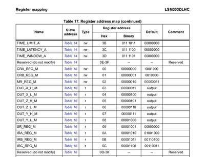

LSM303 :

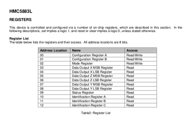

And HMC5883L:
The LSM303 has an additional accelerometer, and those registers are located at higher addresses.
The magnetometer section of both is so far identical - although some parameters are not, it seems.
At least the maximal update rate of the magnetometer data is different (200Hz vs. 75Hz).
I suppose someone licensed someone else's IP here, and integrated it into his own device.
