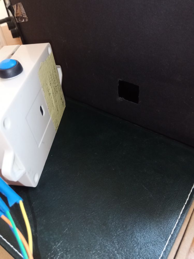

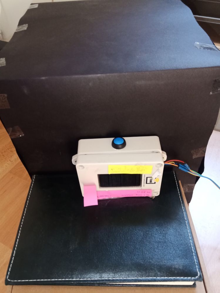

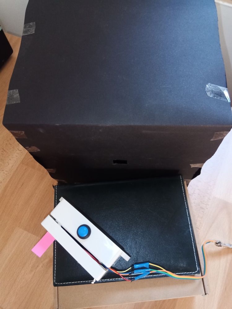

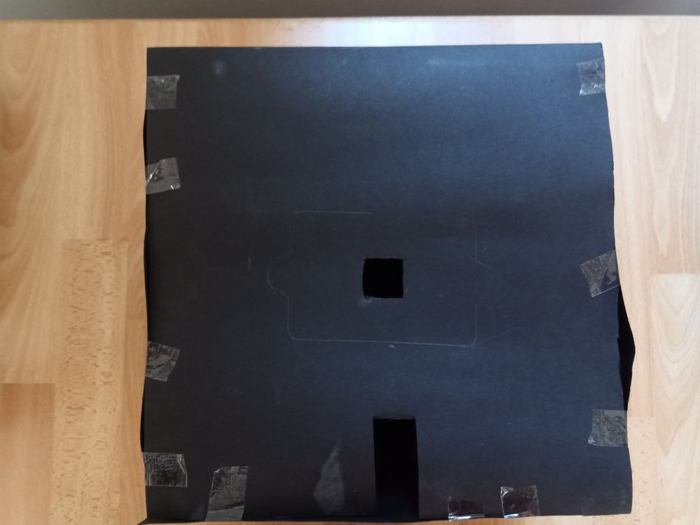

Hi there,
Following this topic, I've made a box out of black paper, perhaps it work for calibrating xTalk.
We couldn't get the customized paper, but here's the box with side's distance = 25cm.
The results of both offset and xTalk are inconsistent, given I'm ranging at night with room's lights off.
Any suggestion to improve the setup to accurately perform both offset and xTalk?
Best Regards,
Hamza Hajeir
