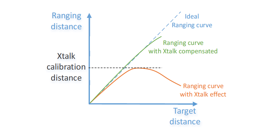

To get correct xtalk value, you need to perform xtalk calibration,
Crosstalk calibration should be conducted in a dark environment, with no IR contribution.
Place a 17 % reflectance chart at the crosstalk calibration distance (xcd),
then call the VL53l1X_CalibrateXtalk(dev, xcd, &xtalk) to get the correct xtalk value.
Once you get the xtalk value you can save this value to your system FLASH, after VL53L1X rebooting, you need read the xtalk value out from FLASH, and set to device by command
VL53L1X_SetXtalk ().
For the clibration distance, the suggested calibration distance will be the inflection point of the raw ranging results (without xtalk compensation).
_legacyfs_online_stmicro_images_0693W00000biHM5QAM.pngFor more details, please check the guide on www.st.com
https://www.st.com/resource/en/user_manual/um2510-a-guide-to-using-the-vl53l1x-ultra-lite-driver-stmicroelectronics.pdf​
