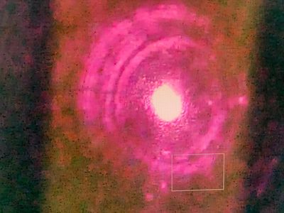

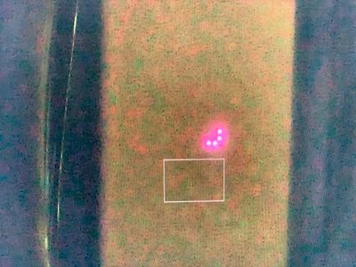

We have an issue with a production build of a VL53L1X based design. The VL53L1X is interfaced to a PIC18F micro, I have inherited the codebase and hardware. The initial production run was for 500 units, of these approx 260 passed our production tests and some have been working well in the field for some time.
The remaining 240 all exhibit an almost identical failure mode. Basically the readings will only

On production units the sensor is protected by glass, with a 3d printed baffle to minimize cross-talk. I've validated that there's no effect from the hardware. The good/bad divide remains the same regardless of whether the glass or baffle is present. I've also validated supply rails are noise free and stable under operation. The "bad" sensors do not look dirty or damaged under the microscope.
I'll be implementing xtalk and offset calibration but I'd like to know if there are any other registers that I should be setting or adjusting? Or could it be that we have a bad batch of VL53L1X  sensors?

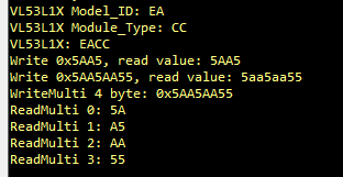

And seeing you got so many null readings, I suspect there is something wrong on the I2C bus communication. I attach a I2C test code to let you verify the I2C link is correct or not.
Br
Zhiyuan.Han
Aurelius
Thanks for the fast reply. I've made a couple of the checks you suggested:
(1) I2C Test Code:
Looks good to me.
Though I did find that the reason for the "null" was that the low level PIC18F driver returned an error instead of 0, this wasn't an issue until I used the value with the Ultra Lite Driver. I've solved this bug but I don't believe it has any bearing on the original issue.

I'm hoping that it's a matter of applying bespoke calibrations. If you see anything in particular with these results please let me know.
Aurelius
I applied the xtalk calibration to both the good and bad sensor. I used a grey target at 150mm.
What can we ascertain from the results below?
Changing  Distance Mode and Timing budget made no difference. Are there any other adjustments I can try?
Could this be a faulty batch of sensors?

I found something interesting here, on the good sensors I can clearly see the laser flash when using an Android camera (you are correct about the iPhone filter). However on the bad sensors I can't see anything at all on the camera.
Under the digital microscope it's even easier to see the difference.
What does this tell us?
Faulty sensor hardware? (I've triple checked my supply rails and connections)
Any firmware settings I can modify?
Good Sensor
Bad Sensor
(Tip for anyone making the same investigation, you may need to reduce ambient light so that your camera/microscope increases exposure time. But be sure to keep the ambient light level and distance the same between sensor samples).
