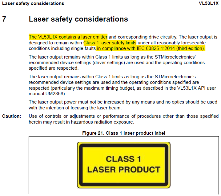

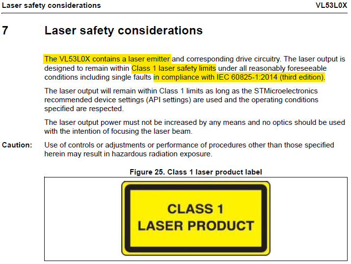

Could you provide the VL53L0X/L1X Laser Safety IEC 60825-1:2014 Compliance Report?
MFabb.1
Our products integrate the above PNs and we would need these documents in order to submit them to the cerification laboratory.
As reported in the datasheet both ToF sensors are "designed to remain within Class 1 laser safety limits under all reasonably foreseeable conditions including single faults in compliance with IEC 60825-1: 2014 (third edition)."
Thank you
