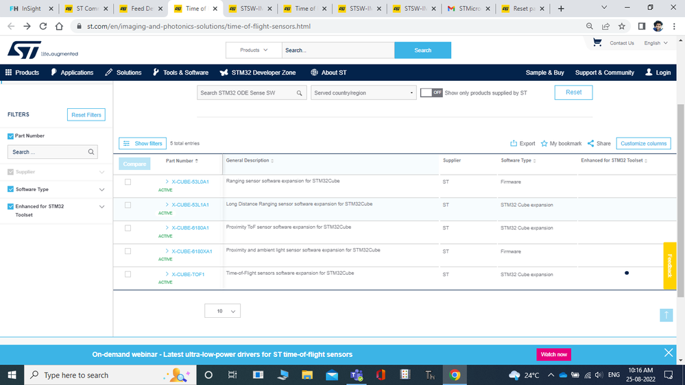

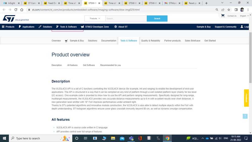

Thank you for ur reply first of all,i understand the register level programming difficulty for this sensor but the ways to get example project for this VL53L4CD is not wrking or seems to be removed by ST itslef.0693W00000Stin9QAB.png STSW-IMG029 the tools and software option,Get software option is not working even after clicking there is some ui issue it seems
0693W00000StinJQAR.png "www.ST.com/TimeOfFlight and select the VL53L4CD, click on tools and software you will get" as u said
In this no example project for VL53L4CD, is listed u may cross check it.Please kindly do reply fast

yes i saw it even before but iam not able to download anything it s just redirecting other specific evaluation board sites,only pdfs are getting downloaded in doc sec,and in tools and software section its simply getting redirected to its specific names.Please try downloading something and if are able to get the sample code downloaded please do reply!!!.
John E KVAM
I just tried it and it works for me. But then I am an employee - so I'm on the inside of the wall. And I've downloaded from ST.com hundreds of time.
The portal does get goofed up from time to time, but it's working now.
If you have trouble go to the ST.com and there is a support tab in the upper right. Pull that down and click on 'support'. We have people who can help. There is even a phone number.
