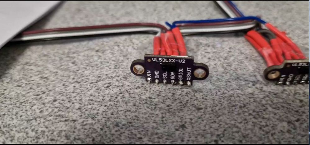

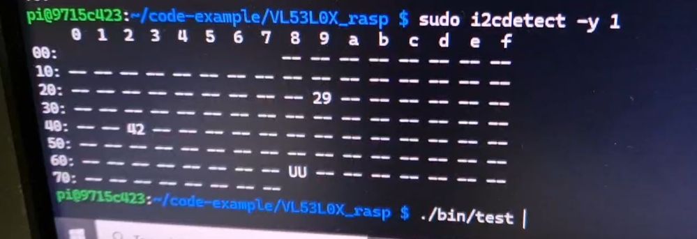

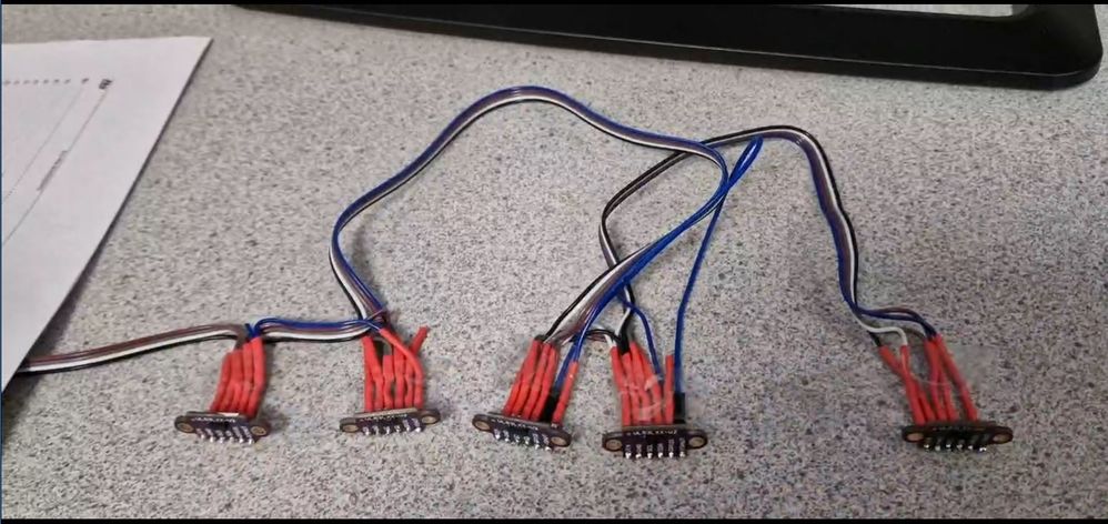

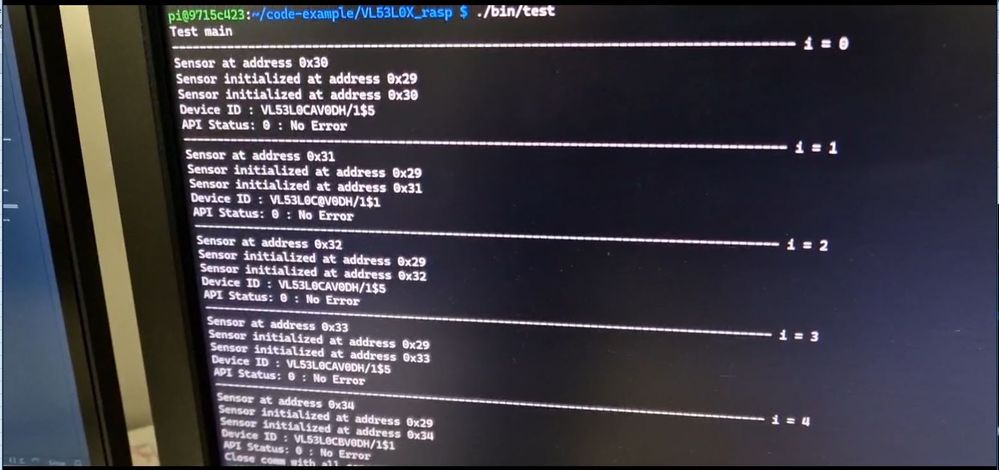

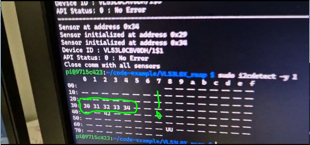

Hi John !
You wrote "Long story short - unfortunately you cannot cheat. You need one line for the Xshut on every sensor." :thinking_face:
Now loock at this :face_with_tears_of_joy: :
Just 4 I2C wires + only a fifth wire in cascade between GPIO pin and XSHUT pin of sensors and wihtout multiplexer.
It seems that you underestimate your products
‎2024-06-04 07:07 AM
So you hooked the GPIO1 (which is the interrupt line) of sensor A to the Xshut of sensor B. And when you are done doing the setup of the first sensor, the GPIO1 goes high (as it is an active low interrupt). But what happens when you start the sensor and you actually get an interrupt? That will drop the interrupt low and turn off the next sensor.
Or did I miss something?
- john
If this or any post solves your issue, please mark them as 'Accept as Solution' It really helps. And if you notice anything wrong do not hesitate to 'Report Inappropriate Content'. Someone will review it.
‎2024-06-04 07:15 AM
You're not far off, that's how the wiring works, you miss some others clever things.:beaming_face_with_smiling_eyes:
Thank you for your non-encouragement and your non-support, it's been a great source of motivation for us. :thumbs_up:
‎2024-06-04 07:51 AM
In that case, I'll bet you a beer you can't do it.
(I do have to admit that I'm frequently wrong. And if you get it to work, feel free to publish how you did it. I don't mind being taught new things.)
