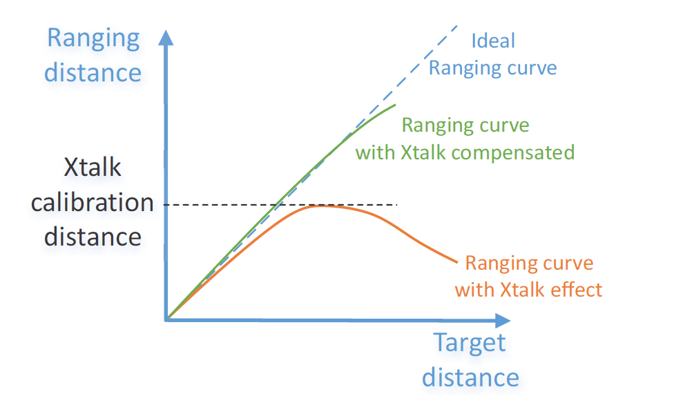

There is a question about argument  VL53L1X_CalibrateXtalk().
For cross talk calibration, we will use  VL53L1X_CalibrateXtalk()  with argument of uint16_t TargetDistInMm,
we should give Xtalk calibration distance to  the argument. But, we wonder  which value should be used for this argument? The one we obtained from VL53L1X_Getdistance(), or the actual distance measured with a ruler?

Hi
When you test VL53L1X with a cover glass on top of it, the cover glass will intrude xtalk, we need to do Xtalk calibration to compensate for the xtalk. see below picture, with cover glass sensor reported distance will be less than the real distance, the best calibration distance is the maximum ranging distance achievable reported by the sensor, or you can call it inflection point.
More detail information, please refer to UM2356.
