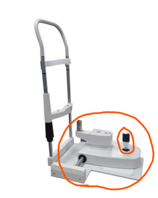

Hi ,we are looking for a distance sensor that meets the below requirements
1.Working distance 5mm to 200mm
2. Resolution steps: 0.01mm steps
 what is the minimum resolution steps your sensor can provide. Let me know if you need anything else.

 can you suggest any sensor for this ??
1. the base moves forward and laternal movements
2.sensor to track the movement of joystick (how miuch it is deviated from initial position  )

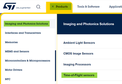

Can you please retry with this one :
Time-of-Flight sensors - Products (st.com)
If the link is not working you can find it here from the st.com page :
