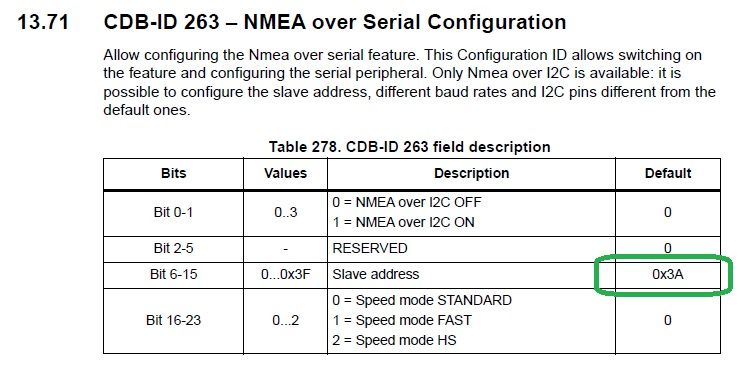

I was checking this AN 5203 : https://www.stmicroelectronics.com.cn/resource/en/application_note/dm00528962-teseoliv3f--i2c-positioning-sensor--stmicroelectronics.pdf
on page 16 the main c code is written.
I wanted to know why we are not enabling the Teseo.I mean which method (if I am not able to find) is enabling the teseo or is it like it is default enabled when we power it ON?
I see the code directly inits the I2C and get the data over i2c?
One more question :
HAL_I2C_Master_Transmit(&hi2c1, 0x3A << 1, (uint8_t *)gpgll_msg, strlen(gpgll_msg), 2000)
>> what is 0x3A << 1 here ?
Is it the Teseo 7 Bit address?
one last question : Where Can I get the information on enabling and getting the similiar data (liek where can I find the list of all NMEA COmmands and thier corresponding commands like this : static const char *gpgll_msg = "$PSTMNMEAREQUEST,100000,0\n\r"; )

I2C here using 7-bit, STM32 expects these in the high order bits, so shifted there.​
