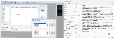

  1. Initially, I was able to use the EVB-T5DR, and the NMEA decoding displayed information correctly. However, for some reason, it suddenly stopped working. When I used the UART tool to read the data, it appeared as Garbled code. How can I resolve this issue?

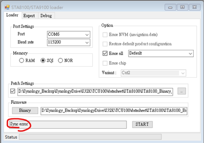

  3. Due to the problem mentioned in the first point, I decided to reflash the device, but I encountered a 'sync error' and couldn't flash it.
I would appreciate your help with the above two issues. Thank you.

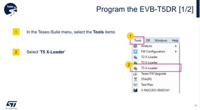

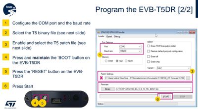

I suggest you:
For the 1st part to follow these steps:
 for the second, you should follow those steps:
Best regards.

I have followed these steps to burn the disc, but it still shows a 'sync error'.

I see you were installing a new firmware.
Could I ask which firmware and which patch (scenario) you were installing?
I think you installed some 'RTCM based scenario' and now the STA8100 is senting RTCM (binary) data.
Regards
 Francesco
Try following these steps:
  1. On the board push and maintain the left (BOOT) white bottom
  2. On the board push and release the right (Reset) white bottom
  3. On Teseo-Suite - T5 Xloader panel - Push 'Start' button
Regards
