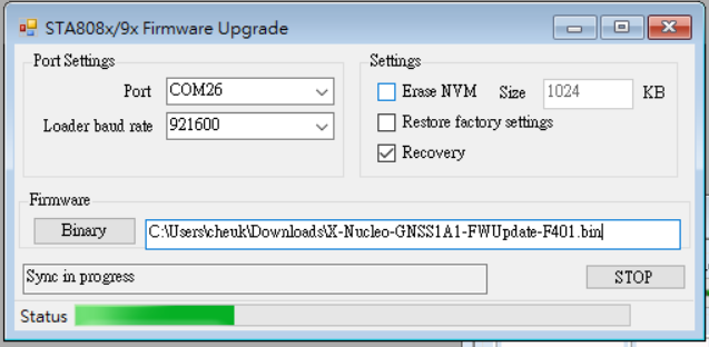

I have tried to use Teseo-Suite Pro 's "STA808x/9x Firmware Upgrade", I select the options "Recovery" and the binary is downloaded from the official website, however the status is keeping at " Sync in progress".
How can I recover the board?

I have tried to use Teseo-Suite Pro 's "STA808x/9x Firmware Upgrade", I select the options "Recovery" and the binary file is the file you provided, however the status is keeping at " Sync in progress". It cannot start the upgrade as below.
I also try different baud rate, it also doesn't work.
Without sync you can reset the Nucleo-F401 again
while in the setting:
  1. Loader-Baudrate @ 115200 (mandatory)
  2. Erase NVM enabled
Regards
Francesco

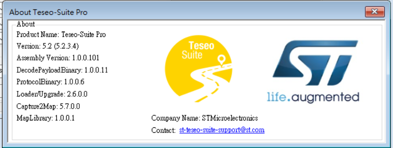

Which Teseo-Suite version are you using?
Regards
Francesco

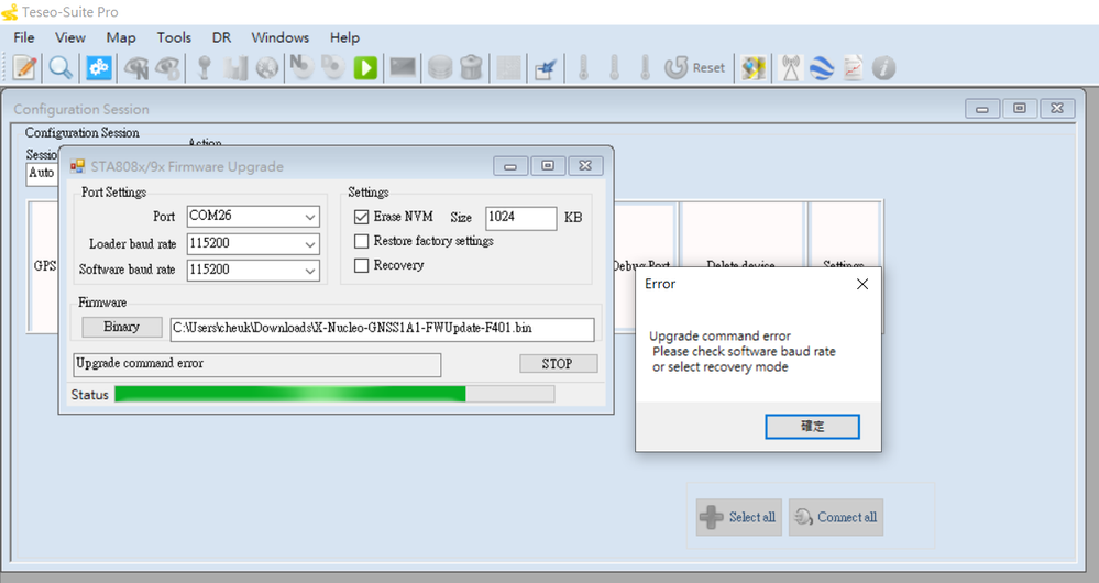

I set baudrate to 115200, and put the reset pin to GND. It keep at "Sync in progress". Is there any other way to reset it?
If I enable the NVM, it failed as below:
Teseo-Suite version is 5.2.3.4
Perfect.
in the FirmwareUpdate panel you have to set:
  • Recovery enabled
  • Erase NVM enabled
  • Baud-rate 115200
Push the start-button in the panel
After that reset the module (Reset to GND) and release the Reset (Reset @ VCC)
While starting the module will sync with PC (via UART) and will upgrade.
Ciao
Francesco
It can be recovered now. Thanks.
