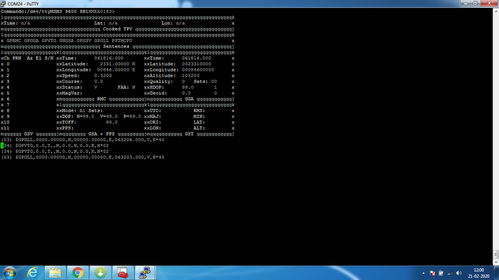

I am working with Teseo-Liv3F to test NMEA0183 strings over BLSP UART 12 on my board.
  1. wanted to know how reset and wakeup are used to monitor UART transfers ?
  2. How can we enable GPGLL, GPVTG on the module to obtain NMEA strings?
To test the antenna used is : FR-01-S4-224 ,also gpsmon application and gpsd daemon .
I am unable to get location fixed , only empty strings are coming.
Is there any info about ways to check firmware file is updated, or to flash the binary on the Teseo-Liv3F module ?
Thanks in advance.

Hi @Francesco Virlinzi​
I am testing with gpsmon application, getting wrong latitude and longitude values(tried almost for 20mins). Is any tuning/calibration required for this GPS module? If tuning required please let us know the procedure to do the same.
Thanks,
Hi
Looking the $GPGLL message... in this message the position is reported... all the fields are zeroed.
The module is not evaluating any Position.
More probably you have some problem with antenna.
I assume you are testing outdoor. Is it?
