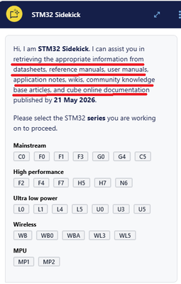

mƎALLEm
As said by @STOne-32, today Sidekick is not intended to generate code or analyze it. It's only intended to help users to find information in the different documentations and this was stated in the Sidekick default prompt:
I didnt make a test...i just tried to get "help" with this strange complicated SPI , because no useful examples also.
