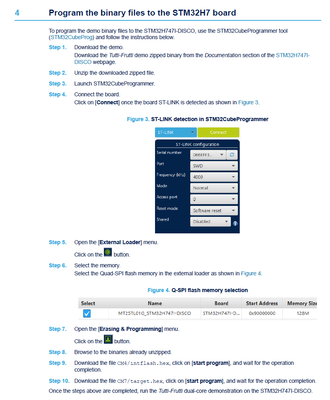

I have an STM32H747I-DISCO board that I am trying to bring up with the Tutti Frutti Demo.   I have followed the instructions in UM3008 to program this as it appeared to be blank upon arrival from Digikey.
External loader was set to:  MT25TL01G_STM32H747I-DISCO
Programming of CM4 with intflash.hex and CM7 with target.hex completed successfully.
After programming, the board does not display anything and LD10 just flashes red a couple of times and then pauses on green then repeats.

So the question here did you follow the steps described in the UM3008 / Section: "4 Program the binary files to the STM32H7 board":
If you followed these steps, it could be due to an incompatible version of the LCD. The marking I have on the board I'm using: MB1166-A03

Yes, I did follow the instructions from UM3008 but unfortunately it did not help.   My board is MB1166-A09.
Not sure but I think it could be related to the LCD version: yours MB1166-A09 and mine is MB1166-A03
WillK
Thanks.  I am heavily leaning that way myself.   After your post, I did a quick search of -A09 vs -A03 and it seems others have found that apparently due to a change in controller there are display issues with some of the prepackaged applications.    For me, I will call this good, but I think it would be good for ST to verify this as the case and post that response here so that others searching for this will immediately find that there is an incompatibility issue so that they don't spend time trying to debug this.    Once that is done, I will mark that response as 'solved'.

I don't think we could verify the case. The demo has been developed by our partner Mjolner in 2021/2022 with an old TouchGFX library/old LCD driver versions. We don't know what board version they had use at that time most probably like I have in hands. But as I said mostly that's due to a LCD revision incompatibility: as you have said LCD driver has been changed.
