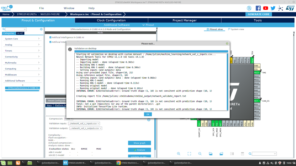

i'm trying to validate the generated C model inside STM32CubeMX.
I'm follow the Getting started documentation (UM2526 - rev 3)
Like page 22, (4.5 Validating the generated C model) i wan't to use custom data-set (CSV file) on inputs and on outputs, but i have an error:
I use previously self-generated values from STM32CubeMX validations files at "/home/user/.stm32cubemx/stm32ai_output/"
Seem to be an issue with shape detection:
With output csv file like this:
# file created : 2019-11-13 15:28:48
# output C-model features - 10/10
9.932567382812500000e+03
1.614522812500000000e+05
-6.814434570312500000e+03
-1.008901718750000000e+05
1.514196777343750000e+03
8.807486328125000000e+03
4.036426171875000000e+04
-3.264179492187500000e+04
-1.473285644531250000e+04
-1.134370546875000000e+05
I have the message: "Using reference output file, shape=(1, 10)"
And if i use csv output file like this:
9.932567382812500000e+03,1.614522812500000000e+05
1.614522812500000000e+05,1.614522812500000000e+05
-6.814434570312500000e+03,1.614522812500000000e+05
-1.008901718750000000e+05,1.614522812500000000e+05
1.514196777343750000e+03,1.614522812500000000e+05
8.807486328125000000e+03,1.614522812500000000e+05
4.036426171875000000e+04,1.614522812500000000e+05
-3.264179492187500000e+04,1.614522812500000000e+05
-1.473285644531250000e+04,1.614522812500000000e+05
-1.134370546875000000e+05,1.614522812500000000e+05
I have the message: "Using reference output file, shape=(10, 2)"
Why shape(x,y) going to shape(y,x)??

I suppose that you have a model with the output shape: (1,).  Effectively the import of the first output csv file seems not correct. Normally we expect a shape=(10,1) not (1,10), 10 samples of 1 dimension.
I look if I reproduce the issue.

I confirm the issue. We have an issue where the csv file has a single row or column. I create a internal  ticket to fix it.
Currently, if you want to use this type of csv file, you need to convert it to npy format for example with the following snippet Python code:
import numpy as np
f_in = 'file_10_1.csv'
f_out = 'file_10_1.npy'
array = np.genfromtxt(f_in, delimiter=',')
n_array = np.reshape(array, (array.shape[0],1))
np.save(f_out, n_array)

Hello Jean-Michel,
Thank you very much for your help,
I confirm that it works well with the npy file
