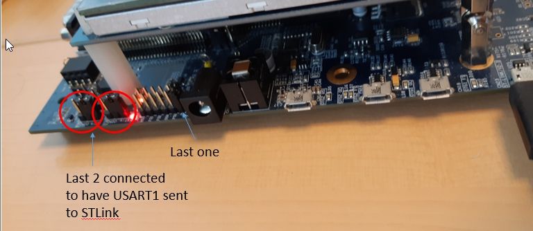

on this board there are some jumpers to put in the right place to have the USART1 sent to the ST-Link
0690X00000AsDfyQAF.jpgand the USART1 is connected on PB14 and PB15
You should be able to use the automatic validation on the target specifying explicitly USART1 and PB14/PB15 for the ports
Otherwise you can always add the validation AI component to your project, enable USART1 in asynchronous mode, then in AI configure the Platform Settings to USART1, generate the code, flash it on the board then go back to MX to launch the validation on the target without auto generation
I've seen on some boards, after a first connection on the PC there is a need to do a reset by hand for the validation to work correctly.
A good practice is to configure the USART to run at 115200 Bauds, this is the default value taken by the underlying command line for validation.

  • I am aware of the jumpers, I have them on the right possition.
  • The USART is configurated at 115200 Bauds too.
  • My connections to the board are power (PSDU DC5V) and usb on CN23 (ST-LINK/V3E).

Just tried a project with STM32CubeMX 5.4, X-Cube-AI 4.1.0, IAR EWARM and it worked fine on that board
Here is what I did
start from the STM32CubeMX board selector and select STM32H743I-EVAL
answer no to initialize peripherals to their default values
add X-Cube-AI 4.1.0 Core and Validation
enable USART1 Asynchonous (it will go to the right pins)
In X-Cube-AI enter the platform settings (USART1) and enter your network
In Project Manager, give a name for the project and in the Code Generator section check "Copy only the necessary library files"
generate the code, compile and flash it.
then go back in X-Cube-AI and launch the validation on the target.
I used the default board configuration (clock at 64Mhz). If you change the D1CPRE clock to 480Mhz you need to also change the RCC Power regulator voltage scale to "Power Regulator Voltage Scale 0"
Hope it helps
