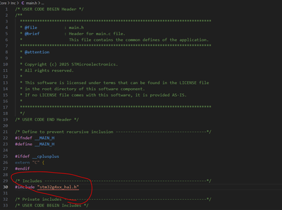

I used vscode with st externsion Ver3.6.4. One day, suddenly, VSCode started showing many red lines and warnings, including "main.h" source file is not valid UTF-8 clang (invalid_utf8).
the file looks like:

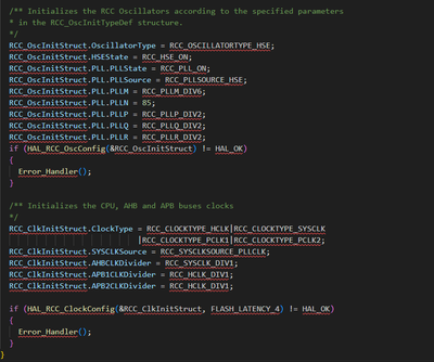

and many other redlines, because of clangd.
how can fix it?  it makes file very ugly, evenif it can be compiled no error.
Thanks.

Hmm, a freshly created STM32G4 CubeMX project works fine here.
So you might have changed or inserted some non-UTF-8 code snippets?
Using git source control right from the beginning might help detecting such changes.
hth
