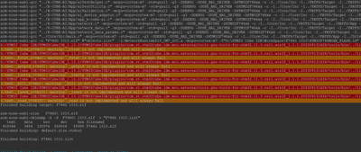

Why i build project error when using CubeIDE13.2 with X-Cube-AI 8.1
‎2023-10-10 12:21 AM
‎2023-10-10 1:43 AM
Hello @123456dad and welcome to the community :),
I think you have the same issue shared in this post.
Please try to use this workaround:
Go to Windows > Preferences
Open the tab Error Parsers into C/C++ > Build > Settings
Select GNU Linker Error Parser, double click on the pattern for the 1st severity Ignore
Changer :
(.*?):?(\(\.[^\s+]+\+.*\))?:\s*(In function [`'"](.*)['"]:)
to :
(.*?):?(\(\.[^\s+]+\+.*\))?:\s*([Ii]n function [`'"](.*)['"]:)
Please let me know if the issue is solved.
Thank you.
Kaouthar.

‎2023-10-10 1:55 AM
The issue is solved, thank you!!
