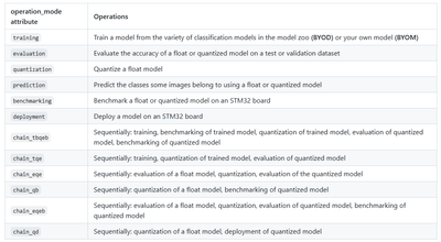

There are different operation mode, you used training that just retrain a model, here are all the operation modes:
https://github.com/STMicroelectronics/stm32ai-modelzoo/tree/main/image_classification
What I generally do is chain_tbqeb  to do everything in one go: to train, benchmark the memory, inference time etc, quantize, evaluate the performance and do a new benchmark to see the difference between the .h5 and the .tfile.
You can use the quantize in your case.
For your first error, I am not sure what caused this, I never used the scripts other than the stm32ai_main.py
For the second error, it seems that a path is wrong and the file cannot be found.
The deployment operation mode generate a binary file flashed directly. If you want to generate a cubeIDE project or cubeMX project, you can take a look at the ST Edge AI Dev Cloud

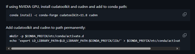

How can I use my nvidia gpu for the training with this script?
